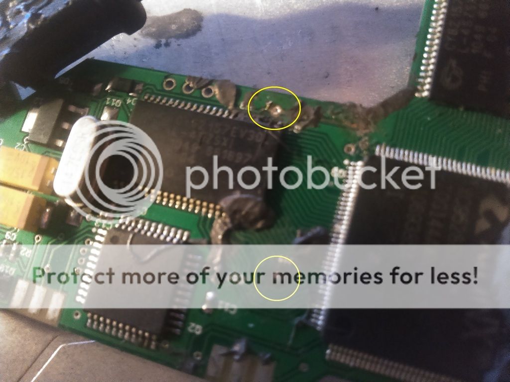

my Quarterhorse had a soldered on battery that i tired to replace in the past. i ended up breaking the tabs so i soldered wires in the spot and put it to the new battery. i guess when messing with the Quarterhorse yesterday, one of the wires broke free so my tune keeps blanking. i went to repair it tonight but now i broke off both wires and unsure which side was positive and negative. can soemone tell me which of these is positive and negative? ignore the RTV everywhere

the two posts on the side edge are positive the single central post is negative

i couldn't view the pics but i soldered and it up alot better this time and shouldn't be an issue ever again. hopefully its right guess ill find out tomorrow when i put the tune on it. appreciate it

grrrr.... its still not working. i must have overheated the 2 points i soldered because they dont have continuity to any other points. i tried tried again in another spot and with my meter shows good this time. i love soldering but not stuff this small. if it doesnt work this time ill probably jsut buy a new quarterhorse. in Binary Editor it shows v1.6 but on the board shows v1.3. not sure if it was updated before but it may be a reason i had issues with datalongging

you can send it in to moates and theyll fix it for you for free
