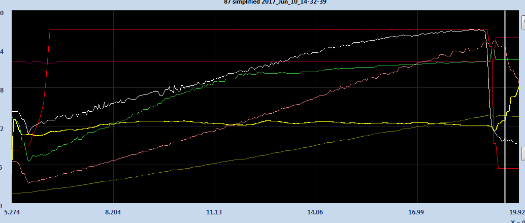

I took the simplified ba2600 curve from decipha site and then multiplied it by 1.25. I made a wot pass in 3rd gear from 14 mph to 90 mph. I targeted a 12.5 afr. It hit the 11's when I first lugged it from a very slow roll. After that, it never left the 12s. Obviously, the yellow line is the afr line with the column on the left showing 12 on that grey line it rides through the rpms.
yellow = afr (which is on the 12 line that got cut off)
red = tp
white = mafv
green = timing
dark green = mph

Also, I don't want to seem over meticulous over this. I actually tried the simplified curve after I made the thread and it just worked out that good after two other guesses.
I didn't notice that my idle and part throttle were rich. I moved the low slope up to 55 and it is now perfect at idle and part throttle. I'm putting the charger back on tomorrow.

As long as it runs well and your AFR matches your LAMBSE, it really doesn't matter what the curve ends up being. These aftermarket products don't have the same kind of quality control OEM stuff does.
