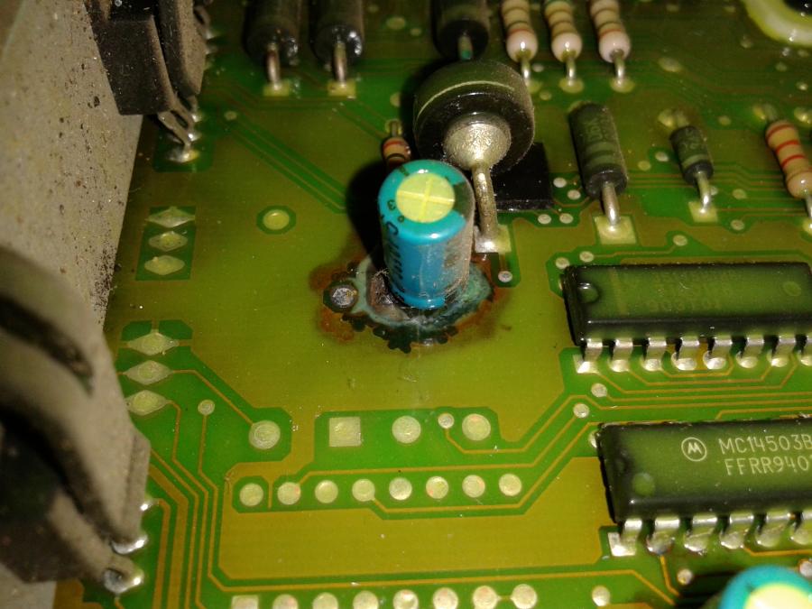

The vast majority of the time, when these go bad, it's capacitors going bad which are easily identified just by looking for domed, bloated, or obviously leaking caps.
Replace the faulty cap and the EEC's back in working order. Anybody with a soldering iron can do that repair. And if you don't have a soldering iron, you can get decent ones for this kind of work on eBay for under $25 inc s/h. If in doubt about what will work as a decent BUDGET soldering station, just search eBay for a 936 soldering station.
In other cases, the EEC is going bad due to electrical damage which can fry traces on the board and whatever components were carrying that current. In those cases, there's more diagnostics to determine what went bad and what needs to be replaced.

I'll open the most recent and look around. I've replaced caps on a GUFx before, don't remember seeing any obvious caps or traces on the first CBAZA that failed. I may not have been looking close enough though.
