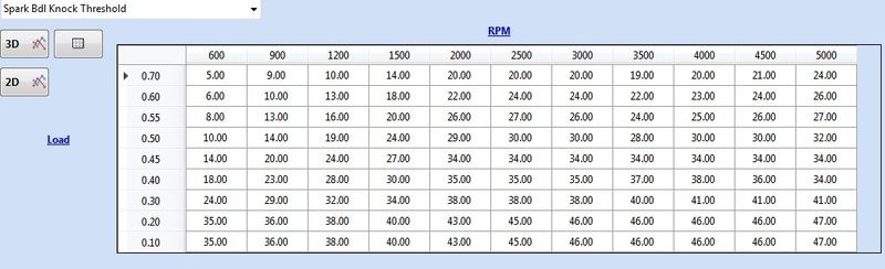

borderline spark table - Image

The only thing I wasn't able to understand was the borderline spark table. I am not sure if I need to scale to 200 or calculate linearly.

the borderline spark table has quite a few a multipliers the values itself is absolutely useless, a value of 60 could return less spark than a value of 10 it just depends on the multipliers, thats why i didnt post it

if you follow the instructions in the zxa5 your timing will be taken care of
with timing simplified such as in the zxa5 your borderline spark table will be the actual spark you receive, if you plug in 50 you will get 50 unlike all stock tunes
