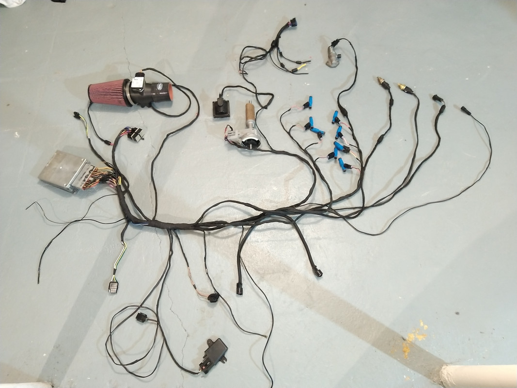

Re: Making a minimalist EEC-IV harness
Sounds to me like he wants to simplify it to reduce risks of things going wrong and the ease of tracing down wiring issues most likely like getting rid of the salt n pepper shakers if his car has them as theyre quite pesky.....
Like stated its pretty ambitious just to do it for the savings of weight.....
My problem was just the opposite...I needed extra length for my project as the harness wasnt installed in a Mustang and wanted to run the wires from the frame up and hidden behind the engine brought forwards but some things your buddy sholdnt shorten are the grounding wires on pins 40 and 60 and dont meld in any grounds to them either.........
In the harness below youll notice by the factory coil and attached off of the branchff is wiring for my MSD 6 box but still have the factor coil attached and thats because the wire the coil is attached to gets tucked away and if the MSD burns out all I have to do is pull the plug off the MSD box and swap the coil output wires and Ill still get home on the stock trigger pulse..
Good Luck
Good Luck
