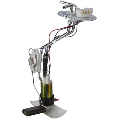

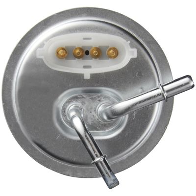

My fuel pump is in an assembly that drops into the tank and has a big plastic ring that threads down on top of it to hold it in place. The pump's pressure-side is connected to a pipe on the assembly using a 2" piece of hose. The sock on the bottom seems to lay against the bottom of the tank, but I can't see inside the tank with it in place to know for sure. The return line is the other pipe on the assembly and just dumps directly to the tank. I think there's a little formed piece of rubber on it, but there's nothing special about it. I think it even points down at an angle. The assembly also holds the level sensor too.
Here are pics care of AutoZone.com:
Interestingly, that piece of rubber hose actually ruptured on my 97 Ranger. It was a simple fix, but it requires pulling the bed off the truck to get the sending unit out. And believe me, pulling the bed off is actually easier than dropping the tank down. That's an absolute PITA that I'll never do again if I don't have to. If I do, I'll pull the bed off to make it easier to get that tank down and back in place. I've pulled the bed to do this enough times now that with another pair of hands helping me lift the bed off, I can have the bed off, do the fuel pump repair, and have the bed back on the truck & bolted down in about 35 minutes.
